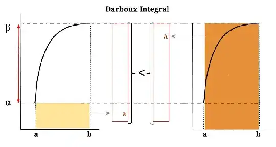

... defining the meaning of Lebesgue integrable and not the definition of the Lebesgue integral, led me to take a wrong turn, confusing the Lebesgue integral with the Darboux integral (as pointed out under comments), more akin to a Riemann integral, although Riemann integration does not use lower and upper sums. Here is a graphic representation:

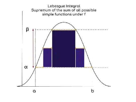

We are looking for the supremum of the sum of all possible simple functions (we can think of them as step functions), under the curve, as beautifully explained here. It makes sense to talk about supremum because we approach the value of the area under the curve with simple functions, which have a limited number of steps.

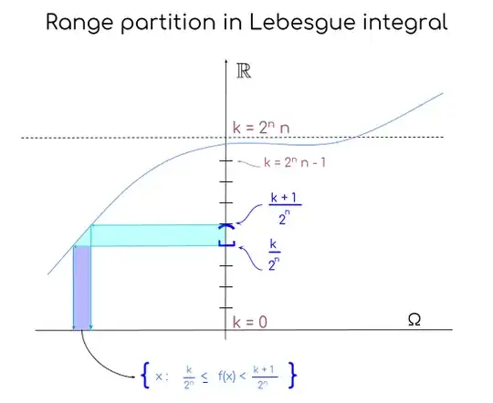

The range or codomain of the function is partitioned fixing a maximum value $n$ into $k=0$ to $k = 2^n n$ intervals at heights $\frac{k}{2^n}$ in order to defined a sequence of simple functions $f_n:$
$$f_n(x) = \sum_{k=0}^{n2^n-1}\frac{k}{2^n}\; \chi_{\frac{k}{2^n}\leq f(x)<\frac{k+1}{2^n}}\; +\; n\,\chi_{f(x) \geq n}$$
i.e. with value $n$ if $f(x)$ is equal or greater than $n,$ and otherwise with the lowest value for that interval, $\frac{k}{2^n}.$ In the indicator function above $\frac{k}{2^n}\leq f(x)<\frac{k+1}{2^n}$ can be alternatively expressed as $k \leq 2^n f(x) < k+1$ with $k=\lfloor 2^n f(x) \rfloor.$ This is explained here. Graphically,

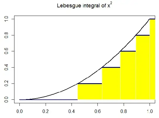

Coding a concept helps, so I tried doing so for this post, illustrating the Lebesgue integral of $y = x^2$ between $[0,1]$. The code is here, and the output looks like this:

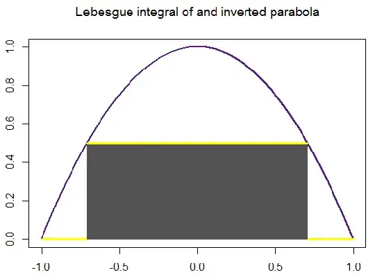

Finally, here is a systematic "construction" of the Lebesgue integral for an inverted parabola, really showing how the critical step is to partition the range (y axis) in $N$ equally spaced divisions between the $y$ limits of integration, defining $[y_i,y_{i+1}]$ intervals, and look for the measure of the pre-image in the $x$ axis: the difference between the inverse function at a given chosen point, $y^*$ (not a slab) for any given $[y_i, y_{i+1}]$ interval, $f^{-1}(y^*_i)$, and the inverse of the next point in the y axis, $y^*_{i+1}$. Analytically, this "strategy" relies ultimately in letting $N\rightarrow\infty$, which explains the "pyramid" iconography so often found online, which is intuitive, but has the potential to suggest the integral as a pile of horizontal slabs. This was a big hurdle understanding the difference between the Lebesgue and the Darboux integrals. Here is an attempt at a more faithful dynamic representation (again the code is here waiting for improvements):
When we extend the partitions to $100$ (a humble computer version of $\infty$) the calculated area is $1.322926$, really close to the analytical value, and identical to the Riemann integral $2\int_0^1 (-x^2 +1)\, dx=4/3.$
You're confusing the things of which the supremum and infimum are taken.
In your drawing, each box is just a term in the sums.
What you should be taken the sup and inf of is this: consider all the partitions of the interval. Calculate all the upper sums with those partitions and put them in a set. Then calculate the infimum of that set.
Do the same with the lower sums.
If those numbers are equal, then the integral exists.
