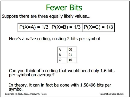

I'm reading the tutorial of Information Gain, and I see the following page: enter image description here
I know in the example above, I can encode this way:
A 0
B 10
C 11
and then this will need $1/3*1+1/3*2+1/3*2=1.6667$ bits per symbol. But how can I code to achieve the 1.58 goal in theory? Is that possible in practice?
