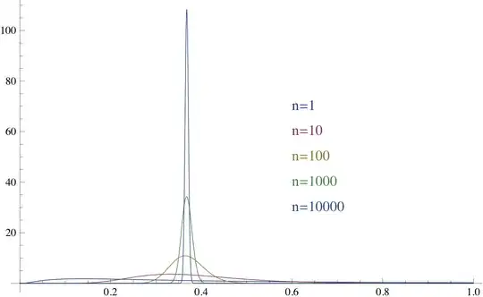

Example 1: For a uniform distribution on $[0,1]$, we have $F(t)=t$ and the $n^\text{th}$ root of the product of $n$ variables tends to $e^{-1}$.
The distribution of the $n^\text{th}$ root of the product of $n$ uniform $[0,1]$ variables approximates $$ \frac{\sqrt{n}}{x\sqrt{2\pi}}e^{-\frac{n}{2}(\log(x)+1)^2} $$ which tends to a Diract Delta at $x=e^{-1}$.
$\hspace{4mm}$log-normal distributions
