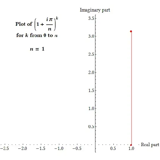

One of the many equivalent characterizations / definitions of $e$ is this:
$$e^x=\lim_{n\to\infty}\left(1+\frac{x}{n}\right)^n$$
Therefore, to find $e^{i\pi}$, we can look at the quantity $$\left(1+\frac{i\pi}{n}\right)^n$$
for higher and higher values of $n$ and see what it approaches. Remember that multiplication of complex numbers works by adding angles and multiplying lengths, and observe that for any given $n$, we have $$\left\lvert1+\frac{i\pi}{n}\right\rvert>1,\qquad \mathrm{arg}\left(1+\frac{i\pi}{n}\right)>0$$ so that as the value of $k$ increases, the complex number $\bigl(1+\frac{i\pi}{n}\bigr)^k$ will rotate counterclockwise in the plane by equal steps while growing in magnitude geometrically, forming a spiral shape. For any given $n$, the value of $\bigl(1+\frac{i\pi}{n}\bigr)^k$ at $k=n$ is what we're interested in, as mentioned before.
(This animation was inspired by the animation from the Wikipedia page on Euler's identity. While mathematically great, I have long been unsatisfied with its quality - it is low resolution, not self-contained, and uses the default style of Mathematica. This is my endeavour to make a better version.)
My Mathematica code:
MyLabel[text_, location_] :=
Graphics[Text[Style[TraditionalForm[text],
FontFamily -> "Linux Libertine", 17, Bold], location]];
EulerPlot[n_] :=
Show[ListLinePlot[
Table[{Re[(1 + I Pi/n)^k], Im[(1 + I Pi/n)^k]}, {k, 0, n}],
PlotRange -> {{-2.6, 1.2}, {-0.2, 3.6}},
AspectRatio -> 1,
ImageSize -> {500, 500},
PlotStyle -> Red,
PlotMarkers -> Automatic,
AxesLabel -> {"Real part", "Imaginary part"},
AxesStyle ->
Directive[FontFamily -> "Linux Libertine", FontSize -> 15]],
MyLabel["Plot of \
\!\(\*FormBox[\(TraditionalForm\`\*SuperscriptBox[\((1 + \
\*FractionBox[\(i \[DoubledPi]\), \(n\)])\), \(k\)]\),
TraditionalForm]\)", {-1.6, 3.35}],
MyLabel["for \!\(TraditionalForm\`k\) from 0 to \
\!\(TraditionalForm\`n\)", {-1.6, 3.02}],
MyLabel[DisplayForm[
RowBox[{"\!\(TraditionalForm\`n\)", "\!\(TraditionalForm\` =\) ",
n}]], {-1.6, 2.65}]];
Export["animation.gif",
Table[EulerPlot[n], {n, {1, 2, 3, 4, 5, 6, 7, 8, 9, 10, 15, 20, 25, 30,
40, 50, 100}}], "DisplayDurations" -> {0.75}, ImageResolution -> 80]

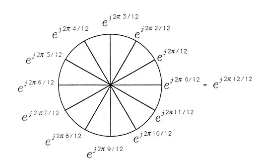

To me, the simplest way to see this is through the roots of unity. Yes, you should go through the proof that $e^{i\theta}=\cos\theta+i\sin\theta$ with the Taylor series, but even after doing so, it may not be apparent why Euler's identity is true. To help visualize it, we can turn to the roots of unity, using the definition of $e^{i\theta}$ in terms of sine and cosine.
Let's define the $n^{th}$ root of unity as a solution of $x^n=1$. So $e^{i\theta}$ is a solution to this if and only if and only if $n\theta$ is a multiple of $\pi$, since we want cosine to be $\pm1$ and sine to be $0$. So the set of all solutions of $x^n=1$ is $e^{\frac{k 2 \pi i}{n}}$, with k running from $1$ to $n$.
Looking at the geometry of it, we can also see that the roots of unity correspond to points of the unit circle on the complex plane:
The x-axis corresponds to the real part, and the y to the imaginary. We can see what $e^{pi i}$ is geometrically by looking at this.
So if we let $n=2$, we see that $e^{\pi i}$ is a root, and that it corresponds to a point on the unit circle at $\theta=\pi$, which is just $(-1,0)$. So that is -1 on the real axis and 0 on the imaginary axis.
So in short, $e^{\pi i}=-1$ because it corresponds to $(-1,0)$ on the unit circle in the complex plane, leaving no imaginary part (since $i\sin\pi=0$).
