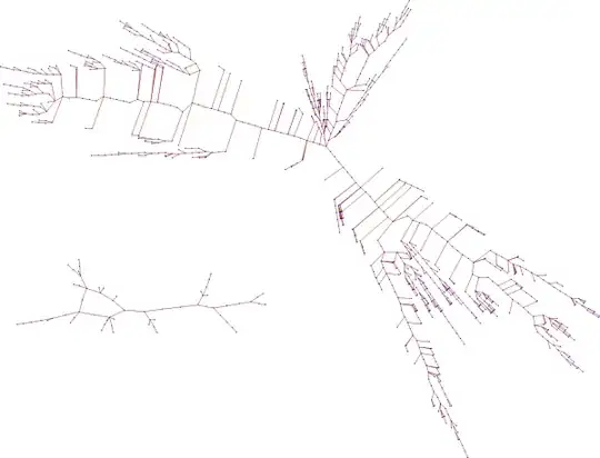

$H_i$ for an individual $F$ depends only on $i$ and the structure of the Functional Graph of $F$, irrespective of its labeling. Here a graph showing a random $F$ (a truncated hash with $m=2^{10}$).
Functional Graph of a random function
