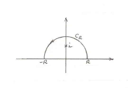

Let $C_{R}$ denote the boundary of the upper half of the disk $ \left\vert z\right\vert =R$, described counterclockwise (see picture). By the residue theorem $$ \begin{eqnarray*} \int_{-R}^{R}\frac{e^{iax}}{\left( 1+x^{2}\right) ^{2}}dx+\int_{C_{R}}\frac{ e^{iaz}}{\left( 1+z^{2}\right) ^{2}}dz &=&2\pi i \underset{z=i}{\ \mathrm{ res}} f(z)e^{iaz} \\ &=&\frac{1}{2}\pi \left( a+1\right) e^{-a}. \end{eqnarray*}\tag{3} $$ Then $$ \begin{eqnarray*} \text{Re}\int_{-R}^{R}\frac{e^{iax}}{\left( 1+x^{2}\right) ^{2}}dx+\text{Re} \int_{C_{R}}\frac{e^{iaz}}{\left( 1+z^{2}\right) ^{2}}dz &=&\text{Re}\frac{1}{2}\pi \left( a+1\right) e^{-a}, \\ \\ \int_{-R}^{R}\frac{\cos ax}{\left( 1+x^{2}\right) ^{2}}dx+\text{Re} \int_{C_{R}}\frac{e^{iaz}}{\left( 1+z^{2}\right) ^{2}}dz &=&\frac{1}{2}\pi \left( a+1\right) e^{-a}. \end{eqnarray*}\tag{4} $$
When $\left\vert z\right\vert =R$, we have
$$\left\vert \frac{1}{(1+z^{2})^{2}}\right\vert =\frac{1}{\left\vert z+i\right\vert ^{2}\left\vert z-i\right\vert ^{2}}\leq \frac{1}{\left\vert \left\vert z\right\vert -|i\right\vert ^{2}\left\vert \left\vert z\right\vert -\left\vert i\right\vert \right\vert ^{2}}=\frac{1}{(R-1) ^{4}}=:M_R\tag{5},$$
which means that $M_R>0$ and $$ \begin{equation*} \lim_{R\rightarrow \infty }M_R= \lim_{R\rightarrow \infty }\frac{1}{(R-1) ^{4}}=0. \end{equation*}\tag{6} $$
Then we can apply the Jordan's lemma for every positive constant $a$ and conclude that
$$ \begin{equation*} \lim_{R\rightarrow \infty }\int_{C_{R}}\frac{e^{iaz}}{\left( 1+z^{2}\right) ^{2}}dz=0. \end{equation*}\tag{7} $$ Consequently,
$$ \begin{equation*} \int_{-\infty }^{\infty }\frac{\cos ax}{\left( 1+x^{2}\right) ^{2}}dx=\frac{1 }{2}\pi \left( a+1\right) e^{-a} \end{equation*}\tag{8} $$ and $$ \begin{equation*} \int_{0}^{\infty }\frac{\cos ax}{\left( 1+x^{2}\right) ^{2}}dx=\frac{1}{4} \pi \left( a+1\right) e^{-a}. \end{equation*}\tag{9} $$
