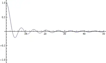

What's more, the second question is somehow incorrect: $\frac{\sin x}{x}$ is bounded on $(0,\infty)$:

The function $\textrm{sinc}(x/\pi)$ is bounded because it is continuous on $[0,a]$ and hence bounded there and has an upper limit estimate $\frac{1}{a}$ on $[a,\infty)$. The divergence is not due to any singularities of $\textrm{sinc}(x/\pi)$ but because of the too slowly decreasing factor $\frac{1}{x}$ of the integrand and periodicity of $\sin(x)$.
