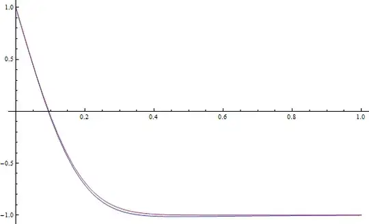

Here's a plot which shows the actual solution in blue and this approximate solution in purple for $\epsilon = 1/50$.
