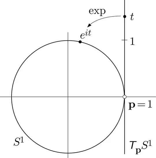

Look at the following figure (from an analysis textbook). For more background, in particular in connection with Lie algebras/groups see the Wikipedia article about the exponential map. The exponential series does indeed appear there.
The function $f(t)=\mathrm{e}^{at}$ can be viewed as the solution of the initial value problem: $$ x'=ax, \quad x(0)=1. $$ More generally, if $A\in\mathbb R^{n\times n}$ and $u_0\in\mathbb R^n$, then the solution of the initial value problem: $$ x'=Ax, \quad x(0)=u_0, $$ is $u(t)=\mathrm{e}^{tA}u_0$, where $\mathrm{e}^{tA}$ is the exponential of the matrix $A$. It $A$ possessed imaginary eigenvalues, then $u(t)$ returns to a multiple of itself, for suitable initial $u_0$.
