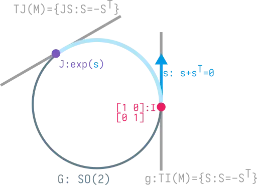

The unit circle: The exponential map
Now, it should be intuitively clear that if we got from $G$ to $\mathfrak g$ using $\log$, we ought to have an inverse $\exp: \mathfrak g \rightarrow G$ which does the opposite. Indeed, this is exactly what it means to have an exponential map: we can go from elements of the Lie algebra $\mathfrak g$ / the tangent space at the identity $T_I G$ to the Lie group $G$.
The unit circle: Computing the exponential map
Assume we have a $2 \times 2$ skew-symmetric matrix $S$. We want to show that its exponential lies in $G$:
$$ \exp(S) = \exp \left (\begin{bmatrix} 0 & s \\ -s & 0 \end{bmatrix} \right) = \sum_{n=0}^\infty S^n/n! $$
We can compute this by making the following observation:
\begin{align*} S^2 = \begin{bmatrix} 0 & s \\ -s & 0 \end{bmatrix} \begin{bmatrix} 0 & s \\ -s & 0 \end{bmatrix} = \begin{bmatrix} -s^2 & 0 \\ 0 & -s^2 \end{bmatrix} = -\begin{bmatrix} s^2 & 0 \\ 0 & s^2 \end{bmatrix} \end{align*}
We immediately generalize, to get $S^{2n} = -(1)^n \begin{bmatrix} s^{2n} & 0 \\ 0 & s^{2n} \end{bmatrix}$
This gives us $S^{2n+1} = S^{2n}S$:
\begin{align*} S^{2n+1} = S^{2n}S = (-1)^n \begin{bmatrix} s^{2n} & 0 \\ 0 & s^{2n} \end{bmatrix} \begin{bmatrix} 0 & s \\ -s & 0 \end{bmatrix} = (-1)^n \begin{bmatrix} 0 & s^{2n+1} \\ -s^{2n+1} & 0 \end{bmatrix} \end{align*}
We can now compute the exponential as:
\begin{align*} &\exp(S) = I + S + S^2 + S^3 + .. = \\ &(I + S^2/2! + S^4/4! + \cdots) + (S + S^3/3! + S^5/5! + \cdots) \\ &= \begin{bmatrix} 1 - s^2/2! + s^4/4! + \cdots & 0 \\ 0 & 1 - s^2/2! + s^4/4! + \cdots \end{bmatrix} + \begin{bmatrix} 0 & s - s^3/3! + s^5/5! + \cdots \\ s - s^3/3! + s^5/5! + \cdots & 0 \end{bmatrix} \\ &= \begin{bmatrix} \cos(s) & \sin(s) \\ -sin(s) & \cos(s) \end{bmatrix} \end{align*}
We get the result that we expect: We get a rotation matrix $\exp(S) \in SO(2)$. We can check that this $\exp$ is indeed an inverse to $\log$.

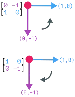

Why skew-symmetric?
What does it mean that the tangent space at the identity $T_I G$ of the group of rotations are the skew-symmetric matrices?
One explanation is to think of these as curl, where a curl is a sort of "infinitesimal rotation". See that a skew symmetric matrix $S \equiv \begin{bmatrix} a & b \\ -b & a \end{bmatrix}$
can be viewed as having two vectors $S_1 = (a, b)$ and $S_2 = (-b, a)$, which represents an infinitesimal rotation from $(a, b)$ to $(-b, a)$.
This is skew-symmetric because rotations in 2D have an orientation. Flipping the order of the vectors gives us the rotations in the opposite order: It takes clockwise to anti-clockwise and anti-clockwise to clockwise. If we wish to fancy, we can talk about this in terms of exterior algebra
See the picture which shows the skew-symmetric matrix $\begin{bmatrix} 0 & 1 \\ -1 & 0 \end{bmatrix}$ and its transpose as "2D orientations"
diagram-skew-symmetric

Recap We saw the following equivalences:
  • We have a Lie group $G$ with Lie algebra $\mathfrak g$, which is the tangent space at the identity $T_I G$.
  • For this, computing the Lie algebra by using the "curves" definition co-incides with simply invoking $\log: G \rightarrow \mathfrak g$ on the definiton of the matrix group.
  • Vice versa, the $\exp$ (inverse of $\log$) can be computed from the series definition, giving us a map $\exp: \mathfrak g \rightarrow G$.
  • These maps allow us to go from the "local behaviour" to the "global behaviour".
  • We gained an intuition for the concrete case of $G = SO(2)$, $\mathfrak g$ as skew-symmetric matrices, and why skew-symmetric matrices are the "infinitesimal rotations"
  • We refer to the fact that if we know $\mathfrak g$/$T_I G$, we automatically know all tangent spaces due to the group being a Lie group. Hence, knowing the lie algebra $\mathfrak g$ is "as good as" knowing the tangent space structure everywhere.
A summary picture: summary-relationships
