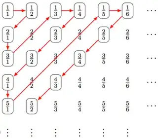

So how do we prove this? We need to find a correspondence, of course. Fortunately, there's a simple way to do this. Let $s_{nm}$ be the $mth$ element of $S_n$. We can do this because $S_n$ is by definition of the problem countable. We can write the elements of ALL the sets like this:
$$s_{11}, s_{12}, s_{13} ...$$ $$s_{21}, s_{22}, s_{23} ...$$ $$s_{31}, s_{32}, s_{33} ...$$ $$...$$
Now let $1 \mapsto s_{11}$, $2 \mapsto s_{12}$, $3 \mapsto s_{21}$, $4 \mapsto s_{13}$, etc. You might notice that if we cross out every element that we've mapped, we're crossing them out in diagonal lines. With $1$ we cross out the first diagonal, $2-3$ we cross out the second diagonal, $4-6$ the third diagonal, $7-10$ the fourth diagonal, etc. The $nth$ diagonal requires us to map $n$ elements to cross it out. Since we never "run out" of elements in $\mathbb N$, eventually given any diagonal we'll create a map to every element in it. Since obviously every element in $S_1 \cup S_2 \cup S_3 ...$ is in one of the diagonals, we've created a 1-1 map between $\mathbb N$ and the set of sets.
Let's extend this one step further. What if we made $s_{11} = 1/1$, $s_{12} = 1/2$, $s_{21} = 2/1$, etc? Then $S_1 \cup S_2 \cup S_3 ... = \mathbb Q^+$! This is how you prove that the rationals are countable. Well, the positive rationals anyway. Can you extend these proofs to show that the rationals are countable?

  • @IntegrateThis skip over already seen elements. This is used in the classic diagonalization proof of countability of the rationals. – qwr Feb 16 '20 at 21:17

    @qwr Why bother skipping over the elements that have already occured? To show it's countable it's sufficient to show there exists a surjection $\mathbb{N} \to \bigcup_{i=1}^{∞}S_i$ so even if it repeats, it doesn't really matter if it's injective or not, count those bad boys again! – William Jan 08 '21 at 14:04
  • I think of a snake that worms its way through each of those elements $$s_{ij}$$ starting with $$s_{11}$$ and moving in a zigzag path. – Mr X Nov 29 '23 at 22:52

Let $A_i=\{a_{i1},a_{i2},a_{i3},...\}$ be the $i$th countable set for $i \in \mathbb{Z}^+$. We can arrange the elements of $\bigcup_{i=1}^\infty A_i$ into an array $M=[m_{ij}]$ where $m_{ij}$ is the $j$th element of the $i$th countable set for $i,j \in \mathbb{Z}^+$. From here we can show $\bigcup_{i=1}^\infty A_i$ is countable by listing the entries of $M$ as follows: first, list every entry $m_{ij}$ such that $i+j=2$; second, list every entry $m_{ij}$ such that $i+j=3$; third, list every entry $m_{ij}$ such that $i+j=4$; and so on and so forth. In general, list all $k-1$ entries such that $i+j=k$ for $k = 2,3,4,...$
Listing entries in this way is analogous to how Cantor listed the rational numbers in his famous proof showing the rational numbers were indeed countable. Simply let $m_{ij} = \frac{i}{j}$ and list the entries as follows
