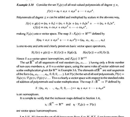

In Peter Szekeres's "A Course in Modern Mathematical Physics" on page 64, he introduces a vector space he denotes $\hat{\mathbb{R}}^\infty$:
The set $\hat{\mathbb{R}}^\infty$ of all sequences of real numbers $(a_0, a_1, \ldots)$ having only a finite number of non-zero members $a_i \neq 0$ is a vector space, using the same rules of vector addition and scalar multiplication given for $\mathbb{R}^\infty$ in Example 3.6. The elements of $\hat{\mathbb{R}}^\infty$ are real sequences of the form $(a_0, a_1, \ldots, a_m, 0, 0, 0, \ldots)$.
The last sentence confuses me. If I've interpreted it correctly, it says that any non-zero element must occur within the first finite number of elements of the sequence. Why must all non-zero elements occur within the first finite number of elements of the sequence? I think I understand why the non-zero elements can't occur at the end of the sequence: the sequence is of infinite length and so the "end" isn't well-defined. Is that reasoning sound? But, why can't we have something like $(0, \ldots, a_0, a_1, \ldots, a_m, 0, \ldots)$ where there are infinite 0s before the first non-zero element, followed by infinite 0s after the last non-zero element? If this is valid, then we can think of variations on this theme. For example, $(a_0, 0, \ldots, a_1, \ldots, a_m, 0, \ldots)$ (i.e., a non-zero element, followed by infinite 0 elements, followed by some finite number of non-zero elements, followed by infinite 0 elements) and other such sequences.
