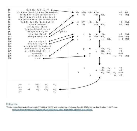

[Please refer also to the image after the last paragraph. The image is also available in PDF.]
A Guiding Principle
A guiding principle for finding integer solutions to the linear equation or system of linear equations is to express the original variables in terms of parameter variables. In other words, the original variables are in a basic solution.
Definition. A variable is in a basic solution if it has a coefficient of 1 in one and only one equation, and considered a dependent variable.
Definition. A basic variable is a dependent variable in a basic solution. By enumerating integer values for the parameter variables, integer solutions are found for the original variables.
Constraint and Variable Generation Step
One way of generating a parameter variable and corresponding equation to support the main idea would be to find an equation where an original variable is not a basic variable, and generate a new parameter variable and corresponding equation for the equation found. Every coefficient for the new equation is the remainder of the corresponding coefficient in the equation divided by the coefficient of the selected original variable. The right-hand constant for the new equation is the remainder of the right-hand constant in the original equation divided by the coefficient of the selected variable. The new system of equations is the previous equations plus the newly generated equation. After solving the new system of equations, if there is still an original variable that is not expressed as a function of parameter variables only, then repeat the “Constraint and Variable Generation Step”. In other words, if an original variable is not a basic variable, then repeat the “Constraint and Variable Generation Step”.
Stopping Criteria: If every original variable is in the basic solution, stop; a solution has been found. If the latest equation added consists of only one parameter variable, stop. If the parameter variable is an integer then there is a unique integer solution; otherwise, there is no integer solution.
Hints For a linear system of equations with more than one equation, it may be worthwhile to perform substitution in Z to express the linear system in diagonal form: if〖 a〗_ij is a diagonal entry then |a_ij |≥1 and a_hj=0 where h≠i. Then proceed with the Constraint and Variable Generation Step.
A Solution to 12x+21y+9z+15w=9
The solution is presented in two columns. The first column contains all the relevant “computations” or “steps in the proof”. The second column was used to guide in the creation of the rows in the first column by presenting the linear system of equations being created. The substitution process was not included in the presentation but the result of each substitution process for converting a linear system to a diagonal form or basic solution is presented in the second column. In all intermediate cases, the newly appended equation is added on the basic solution of the previous linear system.
