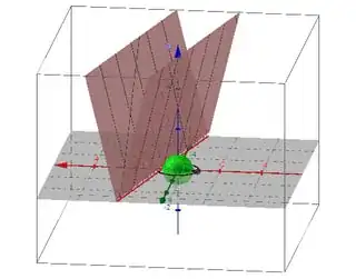

Let us first look at the real case:
2D view 3D view
We see that $f(x,y) = \lvert (k, l) (x,y)^\top + c \rvert$ results in a $V$ shaped surface. The reason is the "case distinction" of the absolute value function.
The valley line (the red line at $z=0$) is $$ \frac{1}{\sqrt{k^2 + l^2}} (k, l) (x,y)^\top = \frac{-c}{\sqrt{k^2 + l^2}} = d $$ where $(1/\sqrt{k^2 + l^2}) (k,l)^\top$ is a unit normal vector to the valley line (see the vector on the unit circle in the left graph) and $\lvert d \rvert$ is the distance to the origin (see the radius of the green circle and green sphere).
