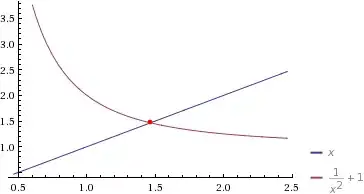

If we plot this, it shows:
For a starting value of $x=1.3$, the fixed point should result in:
$$x = 1.46557137542.$$
