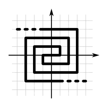

Simple explicit example of $\mathbb{Z} \times \mathbb{Z} \to \mathbb{Z}$ bijection is pictured below. This isn't a very formal definition, but I would say that it should pass as a "clear description" (in particular there are no ambiguities or doubts about whether the function is really 1-to-1 and onto).
$\hspace{70pt}$simple example of ZxZ to Z function using a double spiral
If you are looking for formulas, then the simplest way would be to go through $\mathbb{N}\times\mathbb{N} \to \mathbb{N}$ bijections. My favorite can be found here along with some other (even simpler) examples.
I hope this helps $\ddot\smile$

You can first map $\mathbb Z^2 \rightarrow \mathbb N$ by using a $g$ that maps: $$ (0,0) \rightarrow 0$$ $$ (1,0) \rightarrow 1$$ $$ (1,1) \rightarrow 2$$ $$ (0,1) \rightarrow 3$$ etcetera, in an outward spiral shape. Then you can map $\mathbb N \rightarrow \mathbb Z$ by using the function $h(x)$ that maps $h(2n) = n+1$ and $h(2n+1) = -n$. The mapping $f=g\circ h$ has the properties you are looking for.
