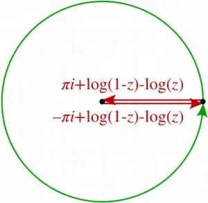

Multiplying and integrating gives
\begin{align}
\sum_{n=1}^\infty\frac{H_{n-1}^2}{n^2}
&=\frac14\int_0^1\log(1-e^{2\pi ix})^2\log(1-e^{-2\pi ix})^2\,\mathrm{d}x\tag{4a}\\
&=\frac1{8\pi i}\oint\log(1-z)^2\log(1-1/z)^2\frac{\mathrm{d}z}{z}\tag{4b}\\
&=\frac1{8\pi i}\int_0^1\log(1-z)^2\left[-\pi i+\log(1-z)-\log(z)\right]^2\frac{\mathrm{d}z}{z}\\
&-\frac1{8\pi i}\int_0^1\log(1-z)^2\left[\pi i+\log(1-z)-\log(z)\right]^2\frac{\mathrm{d}z}{z}\tag{4c}\\
&=-\frac12\int_0^1\log(1-z)^2\left[\log(1-z)-\log(z)\right]\frac{\mathrm{d}z}{z}\tag{4d}
\end{align}
Explanation
$\mathrm{(4a)}$: multiply the conjugates of $(3)$ and integrate
$\mathrm{(4b)}$: convert to contour integral with $z=e^{2\pi ix}$
$\mathrm{(4c)}$: deflate the contour to lines above and below $[0,1]$
$\mathrm{(4d)}$: algebra
Contour $\color{#00A000}{\text{before}}$ and $\color{#C00000}{\text{after}}$ $\mathrm{(4c)}$:
$\hspace{4cm}$![deflate the contour to lines above and below $[0,1]$](../../images/4d0dc718f7849af1eca819dd0fde023b.webp)
