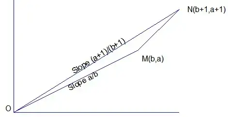

Here is a geometrical explanation in terms of slopes.
If take $b$ for abscissa and $a$ as ordinate of a certain point $M$, adding vector $\binom{1}{1}$ to vector $\vec{OM}=\binom{b}{a}$ will an increase of the slope (due to the fact that $a>b$) as illustrated on the following figure: enter image description here Fig. 1: $(a+1)/(b+1) > a/b$ is equivalent to the fact that slope $ON$ > slope $OM$.
Remark: moreover the signed area of triangle $OMN$ is the half of $\det(\vec{OM},\vec{ON})$ (in correspondence with $\vec{OM} \times \vec{ON}$.
