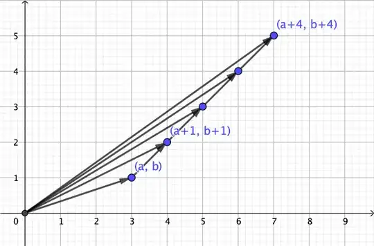

Visually: Consider the slope of the line segment from $(0, 0)$ to $(a+n, b+n$):
Mathematically (assuming $a, b, n > 0$): The distance $$ \left| \frac {a+n}{b+n} - 1\right| = \frac{|a-b|}{b+n} $$ is decreasing in $n$ (and approaches zero for $n \to \infty$).

  • [+1] The value of a fraction as a slope is too rarely found. More generally, there are not enough answers that use graphical representations permiting to have a different, complementary, mental representation. It is what I try to do as well in many of my answers. – Jean Marie Feb 07 '19 at 06:50
