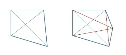

1) The base case is a triangle, having no diagonal. Then take a polygon of $n$ vertices, add a vertex on an edge and displace it. This makes $n-1$ new diagonals appear ($n-2$ to the new vertex plus the original edge). This matches $D(n+1)-D(n)=n-1$.
