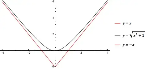

To find an asymptote of a function $y = f(x)$, one needs to evaluate a limits $$ k = \lim_{x \to \infty} \frac yx \\ b = \lim_{x \to \infty} (y - kx) $$ In general, you need to evaluate two pairs of limits when $x \to \pm \infty$, since they might not coincide, which is the case in your problem: \begin{align} k_1 &= \lim_{x \to +\infty} \frac yx = \lim_{x \to +\infty}\frac {\sqrt{x^2+1}}x = \lim_{x \to +\infty} \sqrt{1+\frac 1{x^2}} = 1 \\ k_2 &= \lim_{x \to -\infty} \frac yx = \lim_{x \to -\infty}\frac {\sqrt{x^2+1}}x = \lim_{x \to +\infty}\frac {\sqrt{x^2+1}}{-x} = -\lim_{x \to +\infty} \sqrt{1+\frac 1{x^2}} = -1 \\ b_1 &= \lim_{x \to +\infty} (y - k_1x) = \lim_{x \to +\infty} \sqrt{x^2-1} - x = \lim_{x \to +\infty}\frac {\left ( \sqrt{x^2-1} - x \right )\left( \sqrt{x^2-1} + x\right )}{\sqrt{x^2-1}+x} = \\ &= -\lim_{x \to +\infty} \frac 1{\sqrt{x^2-1}+x} = 0 \\ b_2 &= \left | \text{same analysis} \right | = 0 \end{align} So, your function has two oblique asymptotes when $x \to -\infty$ and $x \to +\infty$ correspondingly: $$ y = \pm x $$

A related problem. Here is how you advance
$$ f(x)=\sqrt{1+x^2}=\sqrt{x^2}\sqrt{1+\frac{1}{x^2}}=|x|\sqrt{1+\frac{1}{x^2}}\sim_{x\to \pm \infty} |x|. $$
