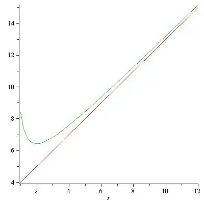

Here is the plot of $x\,e^{2/x}+1$ and the Oblique asymptote $x+3$

@Grant: Try to plot the two functions $x,e^{2/x}+1,, x+3$ on the same graph and see what happens when x gets bigger. – Mhenni Benghorbal Nov 28 '12 at 10:17
