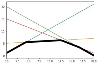

15
See picture below for some intuition on why that may be (bold line is the pointwise infimum of the four affine functions). Similarly, you can conclude that the
Pointwise supremum of the set of affine functions is convex
The point-wise maximum of a set of convex functions is convex. $$g(x) = \max_i f_i(x) $$ The corresponding epigraph $$\{(x,t) | t > \max_i f_i(x)\}$$ is convex which could also be visualized as the insertion of a family of convex spaces, $$\cap_i \{(x ,t)| t > f_i(x)\}$$
The lagrangian could be rewritten as the negative of the supremum, $$lagrangian(x) = \min_i f_i(x) = - \max_i -f_i(x)$$
