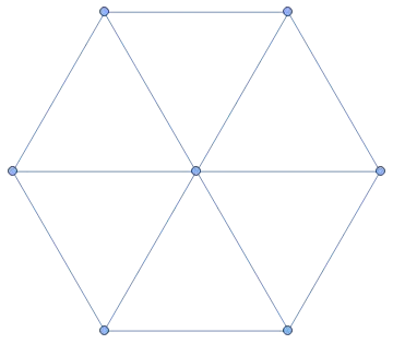

I am looking for a constructive classification of those finite, simple graphs (no loops, no multi-edges), where the open neighbourhood of each vertex (excluding that vertex aka open neighbourhood) is isomorphic to $C_6$; equivalently, where the closed neighbourhood of each vertex including that 'central' vertex is isomorphic to the wheel graph $W_7$ with 6 spokes
W7 graph

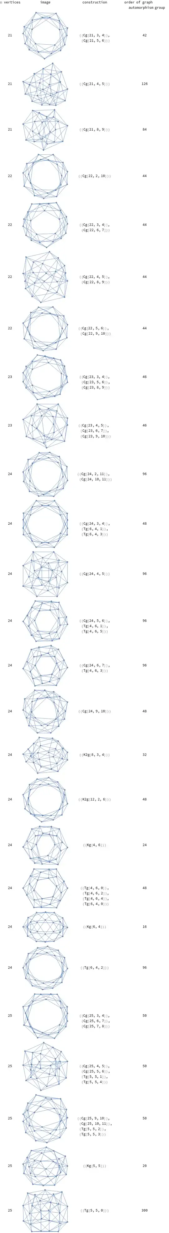

Current best list for small 'locally $C_6$' graphs up to 20 vertices
locally C_6 with v=12 to 20

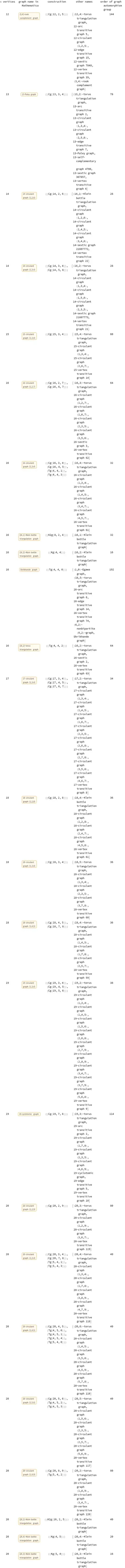

Current best list for small 'locally $C_6$' graphs of 21 to 25 vertices (these have no defined names (yet) in Mathematica)
locally C_6 with v=21 to 25
