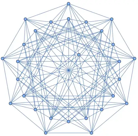

Not really an answer, but {"NoncayleyTransitive",{28,13}} is locally $C_9$
Graph[GraphData[{"NoncayleyTransitive",{28,13}}], VertexCoordinates->Join[Thread[{2,3,5,8,9,10,7,6,4}->1.3CirclePoints[9]],{1->{.2,.3}}, Thread[{20,18,23,19,22,17,21,14,25,16,26,11,28,12,27,15,24,13}->(Reverse/@CirclePoints[18])]]]

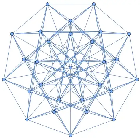

Another embedding, perhaps more clear.
ResourceFunction["DragGraphVertices"][Graph[GraphData[{"NoncayleyTransitive",{28,13}}], VertexCoordinates->Join[Thread[{3,5,8,9,10,7,6,4,2}->(-1CirclePoints[9])],{1->{0,0}}, Thread[{18,13,15,12,11,16,14,17,19}->.7CirclePoints[9]],
Thread[{26,25,21,22,23,20,24,27,28}->.5CirclePoints[9]]]]]
