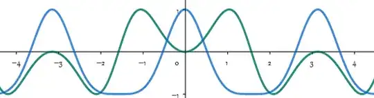

Sometimes looking at graph helps. Solutions
Looking at the graph, the solutions between $0$ and $2\pi$ are:
$0.4$ , $2$ , $4.3$ and $5.9$. If your values more or less evaluate out to $2\pi \pm$this solution set, your solution set is correct.

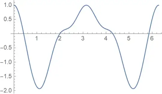

The equation $$\cos(\pi \sin x)=\sin (\pi \cos x)$$ $$\implies \cos(\pi \sin x)=\cos(\pi/2-\pi \cos x)$$ $$\implies \pi \sin x= 2n\pi\pm (\pi/2-\pi \cos x)$$ $$\implies\frac{ \sin x\pm \cos x}{\sqrt{2}}=\frac{2n\pm 1/2}{\sqrt{2}}.$$ Only $n=0$ is valid $$\implies \cos(x-\pi/4)=\frac{1}{2\sqrt{2}}\tag{1}$$ $$\implies \cos(x+\pi/4)=\frac{1}{2\sqrt{2}}\tag{2}$$ From $(1)$, we get, when $m=0,\pm 1,\pm 2, \pm 3,...$ $$x=2m\pi \pm\frac{\pi}{4}\pm \cos^{-1}\left(\frac{1}{2\sqrt{2}}\right)\tag{3}.$$ Below here is the plot of $f(x)=[\cos(\pi \sin x)-\sin(\pi \cos x)]$ whose period is $2\pi$. Using $(3)$ we get the first four roots of $(*)$ in $(0,2\pi)$ as $x=0.4240, 1.9948, 4.2883, 5.8591$ enter image description here
