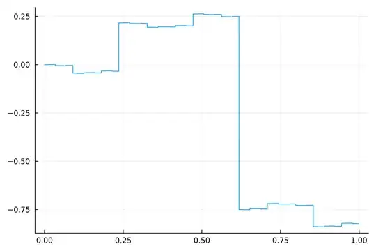

For example, the below image depicts the function $f$ that has, for all $n\geq1$, a jump at $\{\varphi n\}$ of size $(-1)^n/n^2$, where $\varphi=(\sqrt5-1)/2$ is irrational, so there are infinitely many jumps between $f(0)=0$ and $f(1)=-\eta(2)=-\pi^2/12$. The total variation of $f$ is $TV(f)=\zeta(2)=\pi^2/6$ per Euler. draw_jump_example.png The plotting software makes discontinuities look like vertical lines, but you get the idea. This example should make it clear that a jump function is not necessarily constant, or monotone, or continuous, over any open interval.
