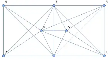

For $n=2$, there is a 'double-toroidal' graph with $8$ vertices and $22$ edges DT8-22
In Mathematica, it is g=GraphData[{"DoubleToroidal",{8,2}}]... and seems to be missing in the house of graphs.

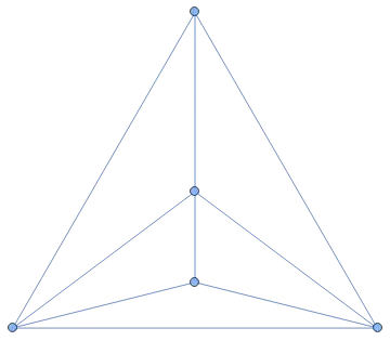

The respective graph complement is the 3-dipyramidal graph GraphData[{"Dipyramid",3}] (plus 3 singletons/ single vertices) which can also be found at https://houseofgraphs.org/graphs/450

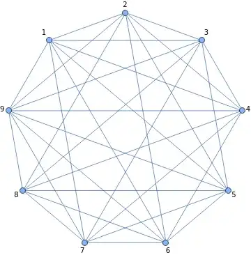

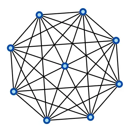

For $n=3$, there is a 'pretzel' graph with $9$ vertices, e.g., $K_9$ with $36$ edges but the house of graph lists a genus 3 graph with $32$ vertices: https://houseofgraphs.org/graphs/394
... that can be imported to Mathematica and displayed with Graph[CanonicalGraph[ImportString["H~z\z~~", "Graph6"]], GraphLayout->"CircularEmbedding",VertexLabels->Automatic]
mathematica
This graph can be constructed from the complete graph with $9$ vertices by removing $4$ unlinked, single edges (put differently, the graph complement consists of a singleton/ single vertex and $4$ $P_2$ graphs).

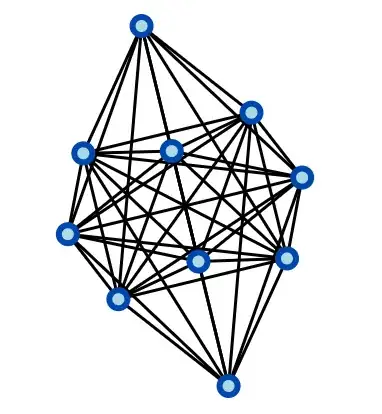

For $n=4$, there is a 'genus n' graph with $10$ vertices, e.g., $K_{10}$ with $45$ edges but the house of graph lists a genus 4 graph with $44$ vertices: https://houseofgraphs.org/graphs/150
genus 4 example

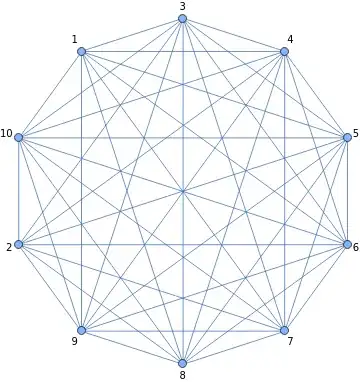

This must be the graph constructed from the complete graph by removing one edge (here $1-2$)
K10 minus one edge
Is this graph the minimal genus 4 graph?
