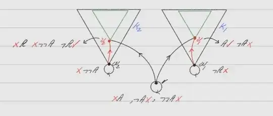

For the first part, my idea is to go with the same line of thought used to prove the disjunction property in IPL. So, I tried to prove the contrapositive form combined with the soundness and completeness theorems. Let us assume that $\nvDash \neg A$ and $\nvDash \neg\neg A$. Then, there are Kripke models $k_1 = (W_1, R_1, L_1)$ and $k_2=(W_2, R_2, L_2)$ with roots $w_1$ and $w_2$ such that $k_1, w_1 \nvDash \neg A$ and $k_2, w_2 \nvDash \neg\neg A$. Here $W_i$ refer to the worlds of the models, $R_i \subset W_i \times W_i$ are reflexive and transitive relations and $L_i$ are labeling functions with the monotone property. We construct a new Kripke model $k=(W, R, L)$ with a the root $w$ such that $W = W_1 \cup W_2$, $R=R_1 \cup R_2 \cup \{(w, v) : v = w \, \text{or} \,v \in W_1 \, \text{or} \, v \in W_2\}$ and $L|_{W_1} = L_1$, $L|_{W_2} = L_2$ and $L(w) = \emptyset$. Now, in the root of the new model, we have $k, w \nvDash \neg A$ and $k, w \nvDash \neg\neg A$. Now, what would be the next step for proving that $k, w \nvDash (\neg\neg A \to A) \to A \lor \neg A$?

Here are the outline of proofs.
  • For the first part, construct the following Kripke model with root $r$ connected to the green models which is shown schematically in the below figure. Use the definition of negation in IPL semantics to see how this construction works for proving the contrapositive form of the first part of the question.
  • For the second part, choose $B=\neg A$. Also, notice that $\vdash_{\mathsf{IPL}} (\neg A \to A) \leftrightarrow \neg\neg A$ and $\vdash_{\mathsf{IPL}} (A \to \neg A) \leftrightarrow \neg A$. Using these facts, it is easy to show that $$\vdash_{\mathsf{IPL}} ((A \to \neg A) \to \neg A) \land ((\neg A \to A) \to A) \leftrightarrow \neg\neg A \to A.$$ Now, use the first part to get the final result.
