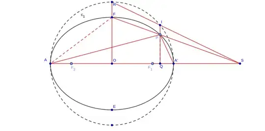

In circle $c_1$ we have:
$IQ^2=AQ\cdot A'Q\space\space\space\space\space\space(1)$
Triangles SIQ and SRO are similar,Also $\triangle SPQ\sim\triangle SFO$ so we have:
$\frac{PQ}{FO}=\frac{SQ}{SO}$
$\frac{IQ}{RO}=\frac{SQ}{SO}$
$\Rightarrow \frac {PQ}{FO}=\frac {IQ}{RO}\space\space\space\space\space\space(2)$
$\frac {PQ}{IQ}=\frac{FO}{RO}\space\space\space\space\space\space(3)$
$RO=a$
$FO=b$
$\Rightarrow \frac{PQ^2}{b^2}=\frac{IQ^2}{a^2}\space\space\space\space\space\space(4)$
$\Rightarrow PQ^2=\frac{IQ^2}{a^2}\cdot b^2\space\space\space\space\space\space(5)$
From (1) and (5) we get:
$\frac {PQ^2}{AQ\cdot A'Q}=\frac{b^2}{a^2}$

  • Should the first line read $A'Q$, not $AQ'$? And the second $SRO$, not $SRQ$. I can't figure out what $(2)$ is supposed to be. As is, how does $FQ$ connect to the similar triangles? You haven't even mentioned $F$. – SRobertJames Jan 14 '25 at 13:16
  • @SRobertJames, Sorry about numerous errors.This is because:1- I am old. 2- I have trouble with my eyes. 3-I was too tired for this job. Anyway I corrected the error. – sirous Jan 14 '25 at 16:16
  • Thanks. But you still haven't explained (2) or how you reason from similar triangles to point $F$. Is there a typo in (2)? – SRobertJames Jan 14 '25 at 16:56
  • @SRobertJames, I explained the reason for (2). – sirous Jan 14 '25 at 20:38
