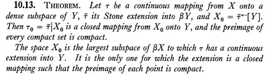

This is true, such maps $g, h$ and locally compact Hausdorff space $Z$ always exist. Consider the following theorem from Gillman and Jerison's Rings of continuous functions:
Consider the extension $\tilde{f}:\beta X\to \beta \overline{f(X)}$ of $f$, according to above theorem if $Z = \tilde{f}^{-1}(\overline{f(X)})$ then $h = \tilde{f}\restriction_Z$ is a perfect map (i.e. closed continuous surjection with compact fibers; such maps are well-known to be proper) onto $\overline{f(X)}$. Note that $\overline{f(X)}$ is a closed subset of locally compact space $Y$ so locally compact, so that $\overline{f(X)}$ is open in $\beta\overline{f(X)}$, and so $Z$ is an open subset of $\beta X$, so locally compact. And since $X$ is locally compact, the embedding $g:X\to Z$ is open. Of course if $K\subseteq Y$ is compact then so is $K\cap \overline{f(X)}$, so any compact $K\subseteq Y$ will have compact preimage $h^{-1}(K)$.
