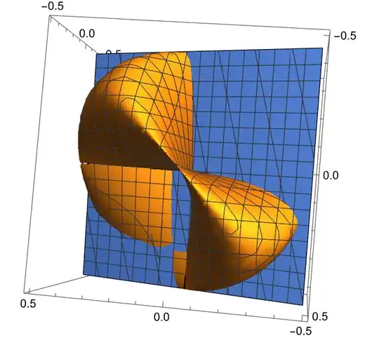

The tangent plane of Roman surface at any point intersects the surface in a quartic curve $\cal C$, how to prove $\cal C$ is reducible over $\mathbb{C}$? Block[{x0=54/121,y0=18/121,z0=12/121},ContourPlot3D[{x^2y^2+y^2z^2+z^2x^2-x y z==0,(z-z0) (-x0 y0+2 x0^2 z0+2 y0^2 z0)+(x-x0) (2 x0 y0^2-y0 z0+2 x0 z0^2)+(y-y0) (2 x0^2 y0-x0 z0+2 y0 z0^2)==0},{x,-1/2,1/2},{y,-1/2,1/2},{z,-1/2,1/2},MaxRecursion->4]]

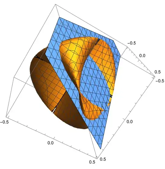

Block[{x0=250/729,y0=50/729,z0=20/729},ContourPlot3D[{x^2y^2+y^2z^2+z^2x^2-x y z==0,(z-z0) (-x0 y0+2 x0^2 z0+2 y0^2 z0)+(x-x0) (2 x0 y0^2-y0 z0+2 x0 z0^2)+(y-y0) (2 x0^2 y0-x0 z0+2 y0 z0^2)==0},{x,-1/2,1/2},{y,-1/2,1/2},{z,-1/2,1/2},MaxRecursion->6]] Similar post: Show that the tangent plane of the saddle surface $z=xy$ at any point intersects the surface in a pair of lines.
