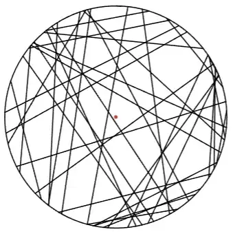

Here is an example with $n=40$.
In this example, the centre of the circle (shown in red) is contained by a pentagon.

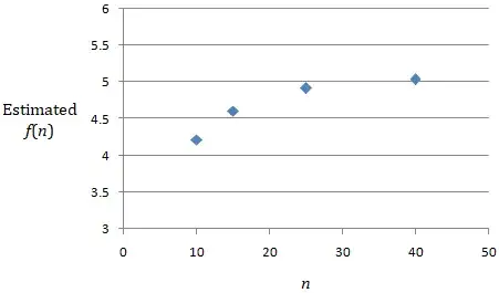

Simulations
I used a random chord generator to run $50$ trials each with $n=10,15,25,40$, and made a graph.

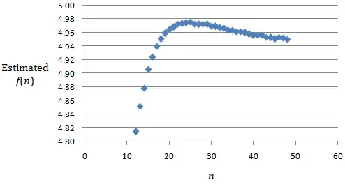

EDIT: In the comments, @ArthurQueiroz provided data from $10^6$ trials up to $n=50$, yielding the following graph.
This is puzzling. Why would $f(n)$ go up, then down? Is there some issue with the simulation?

    Results of my simulations + code: https://pastebin.com/raw/W4HVZZUG It also seems to me that f(n) approaches 5 as n goes to infinity
    .Although the results suggest that f(n) appears non-monotonic beyond a certain point, I believe that f(n) is actually monotonic. The issue likely stems from $10^6$ simulations being insufficient once n surpasses a certain threshold.
    – Arthur Queiroz Oct 21 '24 at 00:40
  • @ArthurQueiroz Thanks for the data. If $f(n)$ approaches exactly $5$, then the probability that a random chord is collinear with a side of the centre-enclosing-polygon, should approach $\frac5n$, which would be an elegant fact, maybe with an intuitive explanation. However, the data show a maximum around $n=27$ and then a fairly strong downward trend for $n>27$; and $10^6$ trials seems sufficient to show the true trend. I'm not convinced yet that $f(n)$ approaches $5$. – Dan Oct 21 '24 at 08:54
    Your "random chord generator" may seem random, but it is not - at least not in the sense you define in the problem. Of course, neither is Arthur Queiroz's, but at least I know that the C psuedo-random number generator has been thoroughly tested and gives a reasonably good distribution. Added to the much larger sample size, his results have to be given preference over yours. One possible explanation for the decreasing $f(n)$ is that the chance for very short sides of the polygon increase with $n$, which then increases the chance that a new side may cut off 2 or more previous sides. – Paul Sinclair Oct 21 '24 at 22:09
  • @PaulSinclair Yes, Arthur's results are much more useful than mine. Good point about the increasing chance of very short sides. – Dan Oct 21 '24 at 22:16
