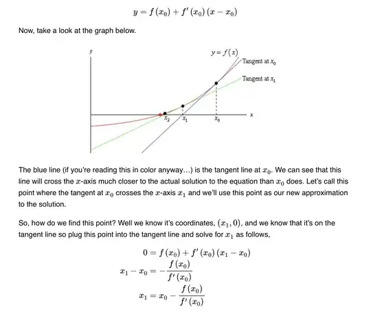

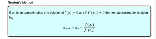

I’m working off the following pictures: a b

  • @notaorb -- You added two pictures about Newtons method to your query. This is only part of the procedure finding several or all roots of a polynomial, the other part is polynomial division. Please don't mistake the statement in the blue box you show, "the next approximation" is not next root of the polynom, it's just a better approximation of the same root. – m-stgt Sep 28 '24 at 20:22

  • I added a couple of pictures to OP. So I follow the method until $f(r_k) < \epsilon$ to get the first root? Then form the binomial $b(x) = x - r_k$ and divide the original polynomial by this, $h(x) = \frac {f(x)} {b(x)}$ using polynomial division. Then perform the method on $h(x)$ where $x_0$ can by any value to find $r_{k+1}$? Keep repeating this will find all roots? Now you say find good starting value for all roots, do you mean starting the method from original $f(x)$ for $r_n, n=0,…,n$ where $n$ is total roots found earlier? This will have better approx for all roots? – notaorb Sep 27 '24 at 22:18
