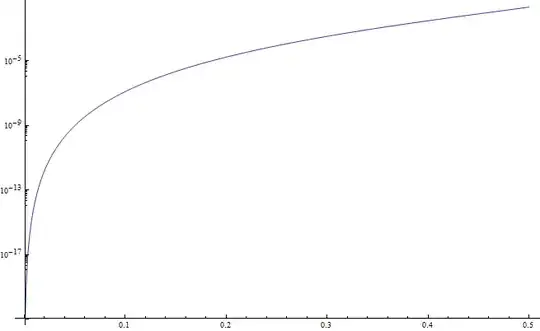

Here's a plot of the absolute error of this approximation with $c$ on the horizontal axis and a logarithmic scale on the vertical (error) axis.

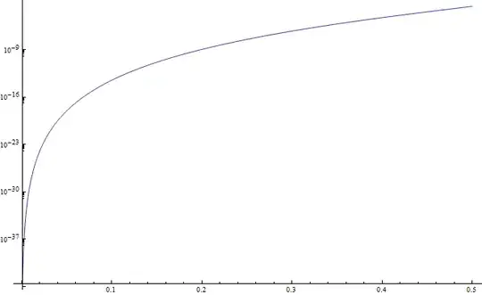

The approximation is still fairly good if we only use the first three terms of the series. Here's the error in that case:

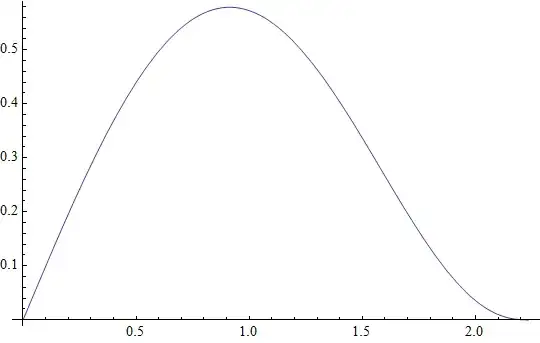

The quantity $x\left(1-\tfrac{1}{5}x^2\right)^{5/2}$ is $0$ when $x=0$, increases to a max of $125/216$ when $x=\sqrt{5/6}$, then decreases to $0$ when $x=\sqrt{5}$. Due to the $5/2$ exponent this quantity is not real for $x>\sqrt{5}$. So (a) when $0<c<125/216$ the equation $x\left(1-\tfrac{1}{5}x^2\right)^{5/2}=c$ has exactly two real solutions, one $<\sqrt{5/6}$ and one $>\sqrt{5/6}$, (b) when $c=125/216$ there is exactly one real solution, namely $x=\sqrt{5/6}$, and (c) when $c>125/216$ there are no real solutions. See this plot:
