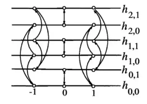

For example, the function $f_1(z) = \sqrt[3]{z^2-1} + \sqrt{\frac{1}{z}}$ has the following scheme (ex. 314 in book):
where $h_{0,1} = \sqrt[3]{z^2-1} - \sqrt{\frac{1}{z}},\; h_{1,0} = e^{\frac{2\pi i}{3}}\sqrt[3]{z^2 - 1} + \sqrt{\frac{1}{z}}$ etc. (principal branches).
He then defines monodromy group of such a scheme as a group generated by permutations of sheets of Riemann surfaces, which arise when one interprets arrows on this scheme as permutations of sheets, numbered arbitrarily.

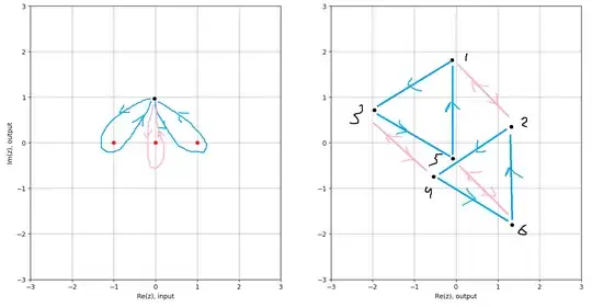

For the function $f_1(z)$, the above diagram gives a group $<(12)(34)(56), (135)(246)> \cong \mathbb{Z}_6$. Using a simple Python code, I've observed the following behavior of its values: which agrees with the group from the scheme of this function. Now, when I consider function $f_2(z) = \sqrt[3]{z^2 - 1} + \sqrt{z}$, I observe the following behavior of its values:

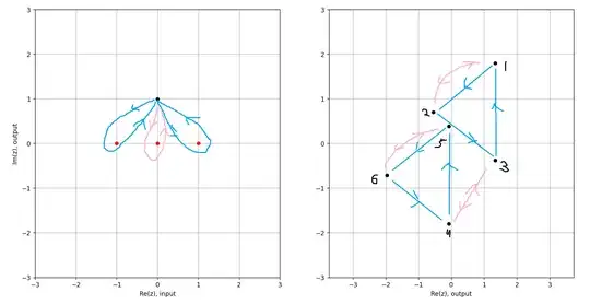

which seems to suggest the group $<(123)(456), (12)(34)(56)>$, which I believe to be isomorphic to $S_4$. However, from my understanding the scheme of Riemann surface for that function must be the same as for $f_1(z)$, because it has the same branch points and counterclockwise rotation around $z = 0$ still results in minus sign on the square root, while the behavior at $z = \pm 1$ is unchanged. So either I've misinterpreted the statement, or I've made mistake in calculations.

I think you may have made an error in your calculations. For the function $f_2$, the pink arrows should go between $1\leftrightarrow 5$, $2\leftrightarrow6$, and $3\leftrightarrow 4$. Up to relabeling, this is the same permutation group as you obtained for $f_1$. We can also see this visually, as each blue triangle represents rotation around $\pm \sqrt{i}$, corresponding to branch changes for $\sqrt[3]{z^2-1}$, and each pink line represents switching between $\pm \sqrt{i}$, corresponding to branch changes for $\sqrt{z}$ or $\sqrt{1/z}$.
