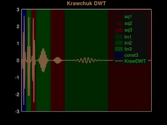

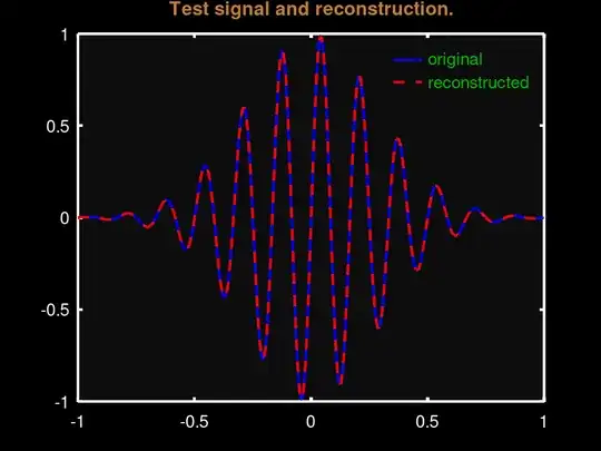

As a minimal example we can consider a vector of $N$ floating point values ${\bf v}^{N\times 1}$, we can call it a signal. Now we can with Kronecker products construct a first level analysis by a block-diagonal matrix followed by a permutation moving all the 0 mod 3 positions first, followed by all the 1 mod 3 positions and lastly all the 2 mod 3 positions. This will allow a "fast transform" and iteration to be possible on the low-pass channel only as the cascade algorithm, or on any number of them as per the wavelet-packet analysis.
One big difference is that for a N polynomial Krawchuck-basis for critical sampling we will have a subsampling of N after each new transform level. In our case with N=3 using the cascade algorithm, the low pass coefficients will be reduced to one third after each step and not one half.
Experiment with DWT filters in old question. Each level has 1 low pass band and 2 high pass bands, giving not dyadic subdivision but rather triadic (?)
