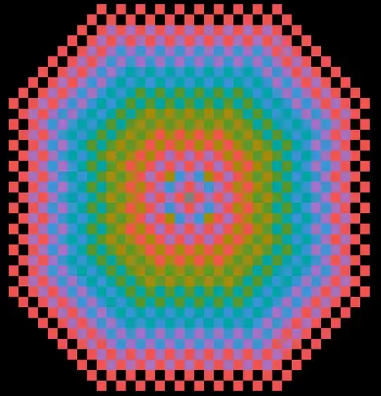

$a = 1, b = 2, n = 9$: (knight) (1, 2) leaper squares

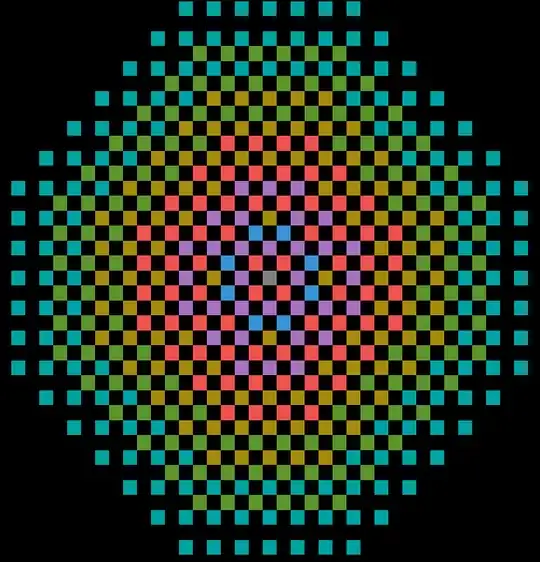

$a = 1, b = 3, n = 6$: (1, 3) leaper squares

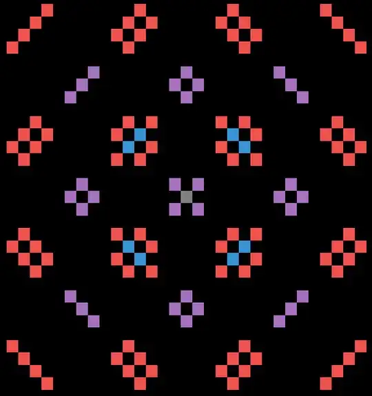

$a = 4, b = 5, n = 3$: (4, 5) leaper squares

  • Note that your diagram for $n=9$ shows a filled-in octagon plus some fuzz around the edges. It may be the case that you get that for all $n\ge4$. If so, you should be able to work out how many squares are in the octagon (as a function of $n$), and how many are in the fuzz, and get a formula for $S_n$ (for $n\ge4$) that way. – Gerry Myerson Aug 12 '24 at 01:07
