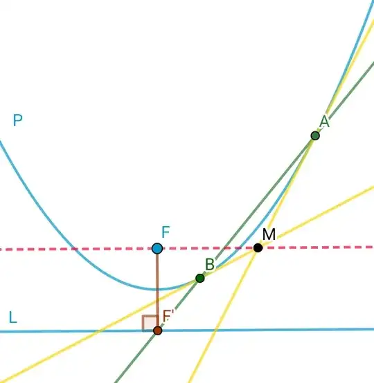

my previous question about finding the harmonic mean using a parabola and my answer, which included a second method. That second method inspired me to try more in this configuration to discover more properties, and indeed I arrived at an initial property that I do not know if it was previously known or not, and it can be formulated as follows: If we have a parabola, let $F'$ be the perpendicular projection of the focus point on the directrix of the parabola. Let us consider a chord of the parabola passing through $F'$. The tangents to the parabola at both ends of this chord will intersect at a point which belongs to the straight line parallel to the directrix and passing through the focus. enter image description here Is this property already known ? Also, are there more known properties of this configuration ?
Also, please mention the references on this subject if it is known in advance.

    Interesting. I don't know if it's novel, but the role of the focus and directrix (or "guide") isn't unique: If $P$ is any point on the axis of symmetry, and $AB$ is a chord whose extension passes through $P$, then the tangents at $A$ and $B$ meet at a point whose projection onto the axis is the reflection $P'$ of $P$ in the parabola's vertex. (Easy case: When $P$ is the vertex.) ... Also, a variant of this property holds for non-parabola conics, although $P$ and $P'$ are more naturally related via the conic's center than its vertex. (This makes me think that the property is known.) – Blue Jul 07 '24 at 06:13
    Thank you @blue, you are right, this property is always true with respect to the electrode and the electrode, I will try to use the same idea for the rest of the properties – زكريا حسناوي Jul 07 '24 at 07:15
  • Pay attention to your translator : the word "electrode" you have used in the previous comments has no mathematical meaning. It is an electrical device... – Jean Marie Mar 21 '25 at 17:26
  • Proof : In fact, this particular property is a direct consequence of the so-called "La Hire theorem" : if the polar line of a point $P$ with respect to a conic curve passes through $Q$, then the polar line of $Q$ passes through P. See p. 14 of this document where a circle replaces the parabola because in projective geometry, a parabola can be replaced by a circle for any proof. Here $P=F'$ and $Q=M$. – Jean Marie Mar 21 '25 at 18:08

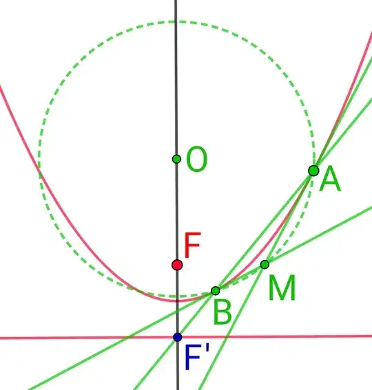

Now I discovered another property related to this configuration The center of the circle passing through the points A, B, M belongs to the axis of symmetry of the parabola

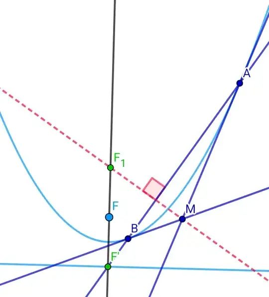

And this is another feature that I have come up with now related to this configuration
The line passing through M and perpendicular to AB must pass from a fixed point which is the image of point F' relative to point F enter image description here

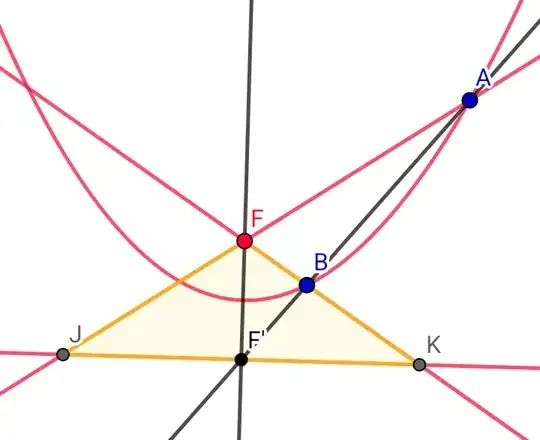

And this is another feature I've just come up with about this configuration.
The two straight lines AF, BF are made with parabola guide isosceles triangle enter image description here
