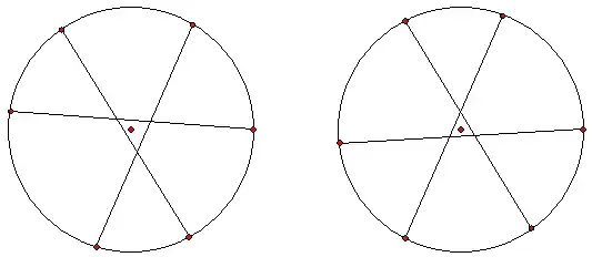

On a circle, choose $6n$ $(n\in\mathbb{Z^+})$ uniformly random points and label them $a_0,a_1,a_2,\dots,a_{6n-1}$ going anticlockwise, with $a_0$ chosen randomly.
Draw three chords:
  • Chord $a_0 a_{3n}$
  • Chord $a_n a_{4n}$
  • Chord $a_{2n} a_{5n}$
Here is an example with $n=5$. The rightmost point is $a_0$. The centre of the circle is shown.
Let $P(n)=$ probability that,when $6n$ uniformly random points are chosen on the circle, the triangle formed by the three chords contains the centre of the circle.
What is $\lim\limits_{n\to\infty}P(n)$ ?

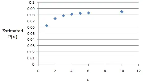

Simulations, with $5\times10^6$ sets of three chords for each value of $n$, yielded the following estimated probabilities:
$P(1)\approx 0.0625\space$ (I prove that $P(1)=\frac{1}{16}$ below.)
$P(2)\approx 0.0741\overset{?}{=}\frac{2}{27}$
$P(3)\approx 0.0786$
$P(4)\approx 0.0809$
$P(5)\approx 0.0824$
$P(6)\approx 0.0832$
$P(10)\approx 0.0849$
I also got $P(100)\approx 0.0872$ based on a simulation with $10^6$ sets of three chords. I tried to get an approximation for $P(1000)$, but my computer started overheating (I'm using Excel for my simulations).
Here is a plot of estimated $P(n)$ against $n$.
So as $n$ increases, it seems that $P(n)$ is approaching some number strictly between $0$ and $1$.
Due to the naturalness of my question's geometric construction, I suspect that $\lim\limits_{n\to\infty}P(n)$ has a closed form, and it should be an interesting number worth finding. I also suspect that $P(n)$ is a rational sequence.

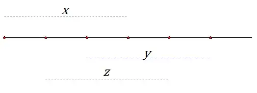

Let $x=$ distance from $a_0$ to $a_3$ along the circle going anticlockwise.
Let $y=$ distance from $a_2$ to $a_5$ along the circle going anticlockwise.
Let $z=$ distance from $a_1$ to $a_4$ along the circle going anticlockwise.
If the triangle contains the centre of the circle, then either
  • $x\le k$ and $y\le k$ and $z\ge k$, or
  • $x\ge k$ and $y\ge k$ and $z\le k$.
These two configurations are shown respectively below, where $a_0$ is the rightmost point in each diagram.
By symmetry, each of these happens with equal probability, so we have:
$$P(1)=2\times P(x\le k \land y\le k\land z\ge k)$$
To see these distances more clearly, imagine cutting the circle at $a_0$ and straightening the circle into a line segment, so that the points from left to right are $a_0, a_1, a_2, a_3, a_4, a_5$.

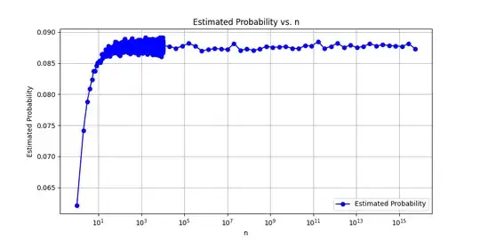

Update: A much more efficient code based on the other response (I don't understand a lot of probability so gamma functions are new to me).
import numpy as np
from numba import njit, prange
@njit(parallel=True) def simulate_probability(n, trials=1_000_000): count = 0 for _ in prange(trials): samples = np.random.gamma(n, 1, 6) s1, s2, s3, s4, s5, s6 = samples if (s1 + s2 + s3 > s4 + s5 + s6 and s2 + s3 + s4 < s5 + s6 + s1 and s3 + s4 + s5 > s6 + s1 + s2): count += 2 # Cool answer below shows the symmetrty return count / trials
n = 10**16 probabilities = [] n_values = [] i = 1 while i <= n: probability = simulate_probability(i) probabilities.append(probability) n_values.append(i) print(f"Estimated Probability P({i}) =", probability)
if i &lt; 1000:
    i += 1
elif i &lt; 10000:
    i += 2
else:
    i *= 2
plt.figure(figsize=(10, 5)) plt.plot(n_values, probabilities, marker='o', linestyle='-', color='b', label='Estimated Probability') plt.xscale('log') plt.title('Estimated Probability vs. n') plt.xlabel('n') plt.ylabel('Estimated Probability') plt.grid(True) plt.legend()
plt.savefig('estimated_probability_vs_n.png', format='png', dpi=300) plt.show()
