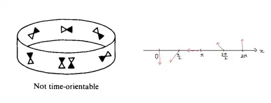

To give an example of a non-time-orientable Lorentzian metric on the cylinder, consider the following picture: enter image description here
The picture on the left is from O’Neill Chapter 5, figure 5 (page 145), and the picture drawn on the right is an example of a vector field in the covering space $\Bbb{R}^2$ of the cylinder. Intuitively, the red vector field rotates clockwise as we right along the $x$-axis, i.e the timecones are themselves rotating; and if we arrange the speed of rotation correctly, the timecones after moving $2\pi$ will be in the flipped order, so when we project to the quotient, we’ll get an inconsistency.
More precisely, on $\Bbb{R}^2$ with coordinates $(x,y)$, let us define the tensor field \begin{align} g&=\cos x\,dx^2-2\sin x\,dx\,dy-\cos x\,dy^2 = -(dx^2+dy^2)+ 2\left(\cos\frac{x}{2}\,dx-\sin\frac{x}{2}\,dy\right)^2, \end{align} where in the second equality I have used the half-angle formulae. Note that the first equality tells us $g$ is symmetric. Next, define the vector fields \begin{align} T=-\sin\left(\frac{x}{2}\right)\frac{\partial}{\partial x} -\cos\left(\frac{x}{2}\right)\frac{\partial}{\partial y},\quad\text{and}\quad X=\cos\left(\frac{x}{2}\right)\frac{\partial}{\partial x} -\sin\left(\frac{x}{2}\right)\frac{\partial}{\partial y}. \end{align} Then, using the second expression for $g$, it is easily seen that $g(T,T)=-1$ and $g(X,X)=1$, and with the first expression $g(T,X)=0$, proving that $g$ has Lorentzian signature and $\{T,X\}$ provides a global $g$-orthonormal frame with $T$ timelike and $X$ spacelike. Btw, the way I got these formulas is I first tried to write down a simple ‘rotating’ vector field like the red arrows above, and this easily gave me the formula for $T$. Then, I started with the general anszatz $g=\alpha\,dx^2+2\beta\,dx\,dy+\gamma\,dy^2$ and tried to choose $\alpha,\beta,\gamma$ to ensure $g(T,T)=-1$, and with a little guess-work I got the above formula, and lastly it was easy to see that $X$ as defined above satisfies $g(X,X)=1$ and $g(T,X)=0$, proving that $g$ is indeed Lorentzian.
Now, consider the action of $\Bbb{Z}$ on $\Bbb{R}^2$ defined as $n\cdot (x,y)\equiv \theta_n(x,y):= (x+2\pi n, y)$. The quotient is the cylinder: $M:=\Bbb{R}^2/_{\theta}\Bbb{Z}\cong (\Bbb{R}/2\pi \Bbb{Z})\times\Bbb{R}\cong S^1\times\Bbb{R}$. Also, the action consists of isometries of $g$: $\theta_n^*g=g$ (using the basic trigonometric facts that $\sin\left(\frac{x}{2}+n\pi\right)=(-1)^n\sin\left(\frac{x}{2}\right)$, and likewise for $\cos$, but this sign disappears because it is squared). Hence, $g$ descends to a Lorentzian metric $\widetilde{g}$ on the cylinder (if by abuse of notation you use local coordinates $(x,y)$ on $S^1\times \Bbb{R}$ with $x$ defined only mod $2\pi$, then it has the same formula as above). Also, it is easy to verify that $\theta_n^*T=(-1)^nT$ (the LHS being pullback of a vector field).
Suppose for the sake of contradiction $(M,\widetilde{g})$ is time-orientable, and let $\widetilde{T}$ be a smooth timelike vector field. Since $\Bbb{Z}$ is discrete, the projection $p:\Bbb{R}^2\to M$ is a covering map, and in particular a local diffeomorphism, so we can define a unique pullback vector field $\tau:=\pi^*\widetilde{T}$ (more precisely, there’s a unique vector field $\tau$ on $\Bbb{R}^2$ which is $p$-related to $\widetilde{T}$). Now, it is easy to verify using $g=p^*\widetilde{g}$ and that $\tau$ is $p$-related to $\widetilde{T}$ to prove that \begin{align} g(\tau,\tau)=p^*\left(\widetilde{g}(\widetilde{T},\widetilde{T})\right)<0, \end{align} and so $\tau$ is timelike. Also, it is straightforward to verify (keeping in mind $p\circ \theta_n=p$) that \begin{align} \theta_n^*\left(g(T,\tau)\right)&=g(\theta_n^*T,\tau)=(-1)^ng(T,\tau). \end{align} Now, since both $T$ an $\tau$ are timelike vector fields it follows $g(T,\tau)$ is nowhere-vanishing hence maintains a constant sign by the intermediate-value theorem. However, this contradicts the above equation which tells us that when $n$ is odd, $g(T,\tau)$ has opposite sign at $(x,y)$ and $\theta_n(x,y)=(x+2\pi n,y)$. Therefore, $(M,\widetilde{g})$ is not time-orientable.
This example specifically is nice in hindsight because the proof really does mimic the intuitive picture, and the contradiction reached via the intermediate-value theorem is a precise way of saying that when we travel $2\pi$ along the $x$-axis, the timecone has flipped.
Some final words about intuition: notice that in both of the examples above, the lack of time-orientability comes from the timecones in the quotient flipping direction as you travel around in a ‘single’ loop (which is only possible due to non simply-connectedness). But a key difference is the reason for the flip. In the Mobius band case, our timecones in the covering space $\Bbb{R}^2$ were the usual ‘upright’ ones, but in the quotient Mobius band, they flipped because the Mobius band itself is defined with a twist. In the cylinder case, the timecones in the covering space $\Bbb{R}^2$ themselves were the ones rotating, and since the quotient is obtained without a twist, it follows that the flip in the covering space still persists in the quotient. In both cases, formalizing the occurrence of the flip is done via the intermediate-value theorem.
