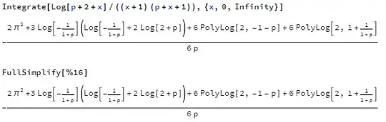

$$-\int\limits_{0}^{\infty} \frac{log(p+2+x)}{(p+1+x)(x+1)} dx$$
When I entered this in Wolfram, it gave me this complicated result:
As you can see, the tool didn't simplify it. I am not very familiar with Polylog functions. Is there a simplification possible?
