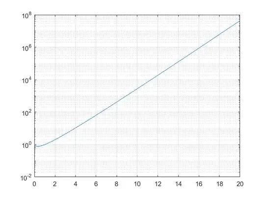

Notice that $\left(\begin{matrix}n\\k\end{matrix}\right) = \left(\begin{matrix}n\\n-k\end{matrix}\right)$ so we only need to check for $k \leq n/2$. This means $$2k < (k!m)^{1/k}+k$$ Therefore $$\frac{k^k}{k!} < m$$ As this grows quite fast for k (as shown in the below plot), only a handful of number of candidates need to be checked. Or one use Stirling approximation $$\frac{k^k}{k!} \approx \frac{e^k}{\sqrt{2\pi k}}$$
log plot of k^k/k!

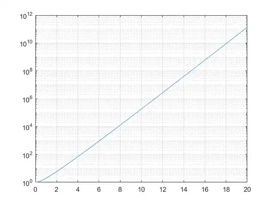

The range for possible values of k can be improved even further by directly using Stirling series:
$$ m = \left(\begin{matrix}n \\ k\end{matrix}\right) \geq \left( \begin{matrix}2k \\ k\end{matrix}\right) > \frac{4^k\left(1+\frac{1}{12k}\right)}{\sqrt{k\pi}\left(1+\frac{1}{12k}+\frac{1}{288k^2}\right)^2}$$
although it's probably faster to compute some values of $\left(\begin{matrix}2k\\k\end{matrix}\right)$ beforehand
log plot of gamma(2*n+1)/gamma(n+1)^2
