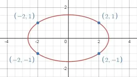

and after removing a trivial factor, it becomes the simple ellipse centered at the origin,
$$p^2 + 3 q^2 = d$$
where $d = 3m^2 n(n+1) (3 n^2 + 3n + 1).$ For example, the ellipse $p^2+3q^2-7=0$.
Choose some desired $d$ with integer $(p,q)$. Thus we need to solve for $m$,
$$m = d\,\sqrt{\frac1{3d n(n+1) (3 n^2 + 3n + 1)}}$$
and find rational $n$ such that $m$ is also rational. Assume prime $d=1\,(\text{mod}\,6)$, or Euler's Theorem, say $d=p^2+3q^2=7$ so $(p,q) = (2,1)$. Then one solution is $n = 1/3,\, m = 3/2$. Substituting $(p,q,m,n)$ into the expressions for $(a,b,c)$, we find,
