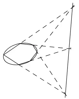

Given an integer $N = p^2+3q^2$ expressible in three ways,
$$N = x_1^2+3y_1^2 = x_2^2+3y_2^2 = x_3^2+3y_3^2$$
it may be useful to let the $(x_k,y_k)$ be signed. So the given identity becomes,
$$N = (-p)^2+3(-q)^2 = \left(\frac{p+3q}2\right)^2+3\left(\frac{-p+q}2\right)^2 = \left(\frac{p-3q}2\right)^2+3\left(\frac{p+q}2\right)^2$$
such that $x_1 + x_2 + x_3 = y_1 + y_2 + y_3 = 0.$ These three $(x_k,y_k)$ will be the vertices of a triangle.
Assume the ellipse $p^2+3q^2-364=0.$ Starting with initial solution $(p,q) = (19,1)$ and using the identity above, we find three vertices. And the other initial solution $(p,q) = (17,5)$ will give three more vertices.
The blue dots give the first triangle, while the green dots give the second triangle. If instead we consider the six points as the vertices of a hexagon, then we have Pascal's Theorem,
$\hskip1.1in$enter image description here
where the three pairs of the continuations of opposite sides meet on a straight line. So there is a relationship between the two triangles. But the question is if we can derive the second from the first.
