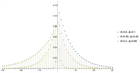

The idea is to first construct a vector-valued random variable that counts the number of successes and failures observed until the stopping criterion is met. Let $(P,N)$ be an ordered pair of nonnegative integers that counts the random number of successes and failures obtained. Additionally, for convenience, let $\theta$ represent the probability of success for a single trial, and $\phi$ be the probability of failure, such that $\theta + \phi < 1$. Then $1 - \theta - \phi$ is the probability of stopping. Consequently, $$\Pr[(P = p) \cap (N = n)] = \binom{p+n}{p} \theta^p \phi^n (1-\theta-\phi), \quad p, n \in \{0, 1, 2, \ldots \}.$$ We reason that a particular sequence of $p$ successes and $n$ failures, followed by a stopping roll, has probability of $\theta^p \phi^n (1-\theta-\phi)$ of occurring; however, there are $\binom{p+n}{p}$ such sequences, each equally probable. As an exercise for the reader, one may confirm that $$\sum_{p=0}^\infty \sum_{n=0}^\infty \Pr[(P = p) \cap (N = n)] = 1.$$ The next step is to compute the net score, which is $X = P - N$. This corresponds to $$\begin{align} \Pr[X = x] &= \Pr[P - N = x] \\ &= \sum_{n=\max(0,-x)}^\infty \Pr[(P = x + n) \cap (N = n)] \\ &= \sum_{n=\max(0,-x)}^\infty \binom{x+2n}{n} \theta^{x+n} \phi^n (1-\theta-\phi) \\ &= \frac{1-\theta-\phi}{\sqrt{1 - 4 \theta \phi}} \begin{cases} \left(\frac{2\theta}{1 + \sqrt{1 - 4 \theta \phi}}\right)^x, & x \ge 0 \\ \left(\frac{1 + \sqrt{1 - 4 \theta \phi}}{2\phi} \right)^x, & x < 0 \end{cases} \\ &= \frac{1-\theta-\phi}{\sqrt{1 - 4 \theta \phi}} \left( \frac{2(\theta \mathbb 1 (x \ge 0) + \phi \mathbb 1 (x < 0))}{1 + \sqrt{1 - 4 \theta \phi}} \right)^{|x|}. \end{align}$$
What this tells us is that $X$ is a kind of generalized double geometric distribution. Here are some plots of $\Pr[X = x]$ for various values of $\theta, \phi$:
heropup
