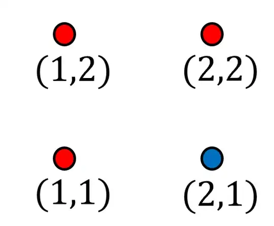

Here is an example (showing only part of the infinite lattice):
Here, red points correspond to the value $1$ and blue points to the value $0$.
If I take $m=0$, the only closed walk at the origin is the one starting and ending there without moving (and the sum along this walk is $1$), and so the device would return the list $(1)$. This measurement allows me to deduce that $f(1,1)=1$.
If $m=2$, I have two closed walks of length $2$ - going up and back, or going right and back. The list of sums along these walks are $(3, 2)$ (but again - I don't know which sums corresponds to which walk). Since I know that the value at the origin is $1$, I can tell that either $f(1,2)=1, f(2,1)=0$ or vice versa. Personally I only care about $f$ up to reflection, so I'm fine with assuming WLOG the first option and continuing.
