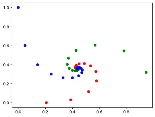

x, y = [[0], [0], [0]], [[1], [1], [1]] for j in range(100): z = f(z) x[j % 3].append(z.real) y[j % 3].append(z.imag)
for i in range(3): plt.plot(x[i], y[i], "o" + "rgb"[i])
Complex plot
One of my brillant student (Esteban Sabatier) remarks this :
The sequence $w_n - \ell$ where $w_n=z_{3n}$ seems to be decreasing in module to $0$ forming a spiral, (it is also the case for $z_{3n+1}-\ell$, $z_{3n+2}-\ell$) but sadly $w_n-\ell$ is not geometric...
My question is how can I prove those sequences converge.
