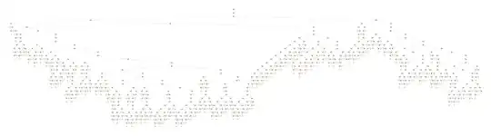

However, I never claimed it's pretty—even the expression for this small machine is too unwieldy to show in standard form. Here's a flat representation of it instead, where log is the natural log, pow is exponentiation, and s is the previous state:
nextState[s] := log[log[pow[pow[pow[-1,pow[log[-1],-1]],pow[pow[pow[-1,pow[log[-1],-1]],pow[log[log[pow[pow[pow[-1,pow[log[-1],-1]],pow[-1,pow[log[-1],-1]]],pow[-1,pow[log[-1],-1]]]]],log[log[pow[pow[pow[pow[-1,pow[log[-1],-1]],pow[pow[-1,pow[log[-1],-1]],-1]],pow[pow[-1,pow[log[-1],-1]],-1]],log[pow[pow[pow[-1,pow[log[-1],-1]],pow[pow[pow[-1,pow[log[-1],-1]],-1],pow[log[log[pow[pow[pow[-1,pow[log[-1],-1]],pow[-1,pow[log[-1],-1]]],pow[-1,pow[log[-1],-1]]]]],-1]]],log[pow[pow[pow[-1,pow[log[-1],-1]],pow[pow[pow[-1,pow[log[-1],-1]],pow[log[log[log[pow[pow[pow[-1,pow[log[-1],-1]],pow[-1,pow[log[-1],-1]]],pow[-1,pow[log[-1],-1]]]]]],-1]],log[s]]],pow[pow[pow[-1,pow[log[-1],-1]],pow[log[log[pow[pow[pow[-1,pow[log[-1],-1]],pow[-1,pow[log[-1],-1]]],pow[-1,pow[log[-1],-1]]]]],-1]],log[pow[pow[log[pow[pow[pow[-1,pow[log[-1],-1]],pow[-1,pow[log[-1],-1]]],pow[-1,pow[log[-1],-1]]]],log[pow[log[pow[pow[pow[-1,pow[log[-1],-1]],pow[pow[pow[-1,pow[log[-1],-1]],-1],pow[log[log[pow[pow[pow[-1,pow[log[-1],-1]],pow[-1,pow[log[-1],-1]]],pow[-1,pow[log[-1],-1]]]]],-1]]],pow[pow[pow[-1,pow[log[-1],-1]],pow[log[log[log[pow[pow[pow[-1,pow[log[-1],-1]],pow[-1,pow[log[-1],-1]]],pow[-1,pow[log[-1],-1]]]]]],-1]],log[s]]]],log[pow[pow[pow[-1,pow[log[-1],-1]],pow[-1,pow[log[log[pow[pow[pow[-1,pow[log[-1],-1]],pow[-1,pow[log[-1],-1]]],pow[-1,pow[log[-1],-1]]]]],-1]]],pow[pow[log[-1],log[log[pow[pow[pow[pow[pow[-1,pow[log[-1],-1]],pow[-1,pow[log[-1],-1]]],pow[-1,pow[log[-1],-1]]],pow[-1,pow[log[-1],-1]]],pow[-1,pow[log[-1],-1]]]]]],pow[log[log[pow[pow[pow[pow[pow[-1,pow[log[-1],-1]],pow[-1,pow[log[-1],-1]]],pow[-1,pow[log[-1],-1]]],pow[-1,pow[log[-1],-1]]],pow[-1,pow[log[-1],-1]]]]],-1]]]]]]],log[pow[pow[pow[-1,pow[log[-1],-1]],pow[-1,pow[log[log[pow[pow[pow[-1,pow[log[-1],-1]],pow[-1,pow[log[-1],-1]]],pow[-1,pow[log[-1],-1]]]]],-1]]],pow[pow[pow[log[-1],log[log[pow[pow[pow[pow[pow[-1,pow[log[-1],-1]],pow[-1,pow[log[-1],-1]]],pow[-1,pow[log[-1],-1]]],pow[-1,pow[log[-1],-1]]],pow[-1,pow[log[-1],-1]]]]]],pow[log[log[pow[pow[pow[pow[pow[-1,pow[log[-1],-1]],pow[-1,pow[log[-1],-1]]],pow[-1,pow[log[-1],-1]]],pow[-1,pow[log[-1],-1]]],pow[-1,pow[log[-1],-1]]]]],-1]],-1]]]]]]]]]]]]]]],log[log[pow[pow[pow[pow[pow[pow[pow[pow[pow[pow[pow[pow[pow[-1,pow[log[-1],-1]],pow[-1,pow[log[-1],-1]]],pow[-1,pow[log[-1],-1]]],pow[-1,pow[log[-1],-1]]],pow[-1,pow[log[-1],-1]]],pow[-1,pow[log[-1],-1]]],pow[-1,pow[log[-1],-1]]],pow[-1,pow[log[-1],-1]]],pow[-1,pow[log[-1],-1]]],pow[-1,pow[log[-1],-1]]],pow[-1,pow[log[-1],-1]]],pow[-1,pow[log[-1],-1]]],pow[log[pow[pow[pow[pow[pow[pow[-1,pow[log[-1],-1]],pow[pow[-1,pow[log[-1],-1]],-1]],pow[pow[-1,pow[log[-1],-1]],-1]],pow[pow[-1,pow[log[-1],-1]],-1]],pow[pow[-1,pow[log[-1],-1]],-1]],pow[pow[-1,pow[log[-1],-1]],-1]]],log[log[pow[pow[pow[-1,pow[log[-1],-1]],pow[-1,pow[log[-1],-1]]],pow[pow[pow[-1,pow[log[-1],-1]],-1],pow[-1,s]]]]]]]]]]],pow[pow[pow[-1,pow[log[-1],-1]],pow[log[log[pow[pow[pow[pow[pow[-1,pow[log[-1],-1]],pow[-1,pow[log[-1],-1]]],pow[-1,pow[log[-1],-1]]],pow[-1,pow[log[-1],-1]]],pow[-1,pow[log[-1],-1]]]]],-1]],log[log[pow[pow[pow[-1,pow[log[-1],-1]],pow[pow[-1,pow[log[-1],-1]],-1]],log[pow[pow[pow[-1,pow[log[-1],-1]],pow[pow[-1,pow[log[-1],-1]],s]],log[pow[pow[pow[-1,pow[log[-1],-1]],pow[pow[pow[-1,pow[log[-1],-1]],pow[log[log[pow[pow[pow[-1,pow[log[-1],-1]],pow[-1,pow[log[-1],-1]]],pow[-1,pow[log[-1],-1]]]]],-1]],log[log[pow[pow[pow[-1,pow[log[-1],-1]],pow[pow[-1,pow[log[-1],-1]],-1]],pow[pow[-1,pow[log[-1],-1]],pow[-1,s]]]]]]],pow[pow[-1,pow[log[-1],-1]],pow[pow[-1,pow[log[log[pow[pow[pow[-1,pow[log[-1],-1]],pow[-1,pow[log[-1],-1]]],pow[-1,pow[log[-1],-1]]]]],-1]],log[log[pow[pow[pow[-1,pow[log[-1],-1]],pow[pow[pow[-1,pow[log[-1],-1]],pow[log[log[pow[pow[pow[-1,pow[log[-1],-1]],pow[-1,pow[log[-1],-1]]],pow[-1,pow[log[-1],-1]]]]],-1]],log[log[pow[pow[pow[-1,pow[log[-1],-1]],pow[pow[-1,pow[log[-1],-1]],-1]],pow[pow[-1,pow[log[-1],-1]],pow[-1,s]]]]]]],pow[pow[-1,pow[log[-1],-1]],s]]]]]]]]]]]]]]]]]
...or, slightly more compactly, in a prefix-ordered shorthand, ^_- being pow, log, -1 respectively:
__^^^-^_--^^^-^_--^__^^^-^_--^-^_--^-^_--__^^^^-^_--^^-^_---^^-^_---_^^^-^_--^^^-^_---^__^^^-^_--^-^_--^-^_---_^^^-^_--^^^-^_--^___^^^-^_--^-^_--^-^_---_s^^^-^_--^__^^^-^_--^-^_--^-^_---_^^_^^^-^_--^-^_--^-^_--_^_^^^-^_--^^^-^_---^__^^^-^_--^-^_--^-^_---^^^-^_--^___^^^-^_--^-^_--^-^_---_s_^^^-^_--^-^__^^^-^_--^-^_--^-^_---^^_-__^^^^^-^_--^-^_--^-^_--^-^_--^-^_--^__^^^^^-^_--^-^_--^-^_--^-^_--^-^_---_^^^-^_--^-^__^^^-^_--^-^_--^-^_---^^^_-__^^^^^-^_--^-^_--^-^_--^-^_--^-^_--^__^^^^^-^_--^-^_--^-^_--^-^_--^-^_----__^^^^^^^^^^^^^-^_--^-^_--^-^_--^-^_--^-^_--^-^_--^-^_--^-^_--^-^_--^-^_--^-^_--^-^_--^_^^^^^^-^_--^^-^_---^^-^_---^^-^_---^^-^_---^^-^_---__^^^-^_--^-^_--^^^-
...or, slightly more coherently, as a tree:
CEL tree of TS(2,2)
The state string is represented as $1b_nb_{n-1}\dots b_1b_0$, that is, with a leading $1$ and with the least significant bit being the front of the string. E.g., $s=110100_2=52$ corresponds to a string of $00101$ as they are more usually represented.
