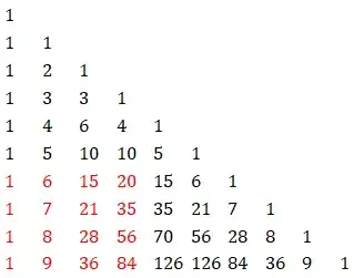

In Pascal's triangle left-justified, take any square matrix that shares a border with the left edge of the triangle. An example is shown in red below.
It seems that the determinant of such a matrix is always $1$.
Is there an intuitive explanation why the determinant of such a matrix is always $1$?

By definition on the lattice $\mathbb Z_+^2$, any entry $a_{ik}=a_{i-1,k} +a_{i-1,k+1}$ with all $a_{ik}=0,k>i$, $a_{1,1}=1$.
It follows, that by subtraction of rows, without change of the determinant, you may transform your square matrix into an upper tridiagonal matrix with all 1 on the diagonal.

Here is another point of view that I will express through 2 examples :
Case $3 \times 3$
$$\left(\begin{array}{rrr}1&7&21\\1&8&28\\1&9&36\end{array}\right)= \left(\begin{array}{rrr}0&1&0\\0&0&1\\1&-3&3\end{array}\right) \left(\begin{array}{rrr}1&6&15\\1&7&21\\1&8&28\end{array}\right)$$
More generally, denoting by $R_k$ the $3$ first entries of the $k$th row of Pascal's triangle that we are concerned with, we have :
$$\underbrace{\left(\begin{array}{r}R_{k+1}\\R_{k+2}\\R_{k+3}\end{array}\right)}_{M_{k+1}}= \underbrace{\left(\begin{array}{rrr}0&1&0\\0&0&1\\1&-3&3\end{array}\right)}_{L_3} \underbrace{\left(\begin{array}{rrr}R_{k}\\R_{k+1}\\R_{k+2}\end{array}\right)}_{M_{k}}$$
which is valid for any $k>1$ with the same matrix $L_3$ where you have may have recognized the coefficients of the $3$rd row of Pascal's triangle (minus the first one) : $1,3,3,1$ with alternated signs.
Taking the determinant on both sides, as the determinant of $L_3$ is $1$, we get :
$$\det(M_{k+1})=\det(M_{k})$$
therefore the result is proven by an immediate recurrence reasoning, knowing that the initial determinant is :
$$\det M_2 = \det \pmatrix{1&2&1\\1&3&3\\1&4&6} = 1$$
Case $4 \times 4$
$$\left(\begin{array}{rrrr}1&6&15&20\\1&7&21&35\\1&8&28&56\\1&9&36&84\end{array}\right)= \left(\begin{array}{rrrr}0&1&0&0\\0&0&1&0\\0&0&0&1\\-1&4&-6&4\end{array}\right) \left(\begin{array}{rrrr}1&5&10&10\\1&6&15&20\\1&7&21&35\\1&8&28&56\end{array}\right)$$
which can be generalized in the same way as in the first case ; for any $k>2$ :
$$\underbrace{\left(\begin{array}{r}R_{k+1}\\R_{k+2}\\R_{k+3}\\R_{k+4}\end{array}\right)}_{M_{k+1}}= \underbrace{\left(\begin{array}{rrr}0&1&0&0\\0&0&1&0\\0&0&0&1\\-1&4&-6&4\end{array}\right)}_{L_4} \underbrace{\left(\begin{array}{rrr}R_{k}\\R_{k+1}\\R_{k+2}\\R_{k+3}\end{array}\right)}_{M_{k}}$$
Here, coefficients $1,4,6,4,(1)$ with an alternated signs are the elements of the $4$th row of Pascal's triangle.
Etc.
Of course, a rigorous treatment is possible if needed, but I think I have conveyed the main ideas by presenting these 2 examples.

This is NOT an intuitive explanation, but it comes from the relations between binomial coefficients.
You can do it by induction. The case of matrices of size $2$ is obvious. If your matrix $M$ has size $k$, and let $L_1,\ldots,L_k$ be the rows of your matrix, do successively the row operations $L_k\leftarrow L_k-L_{k-1}, L_{k-1}\leftarrow L_{k-1}-L_{k-2},\ldots,L_2\leftarrow L_2-L_1$.
Now expand your determinant with respect to the first column. The usual relations between binomial coefficients shows that you get the determinant of the submatrix of $M$ obtained by deleting the last row and last column. Now apply your induction hypothesis.
For example, if you take your matrix in red, performing the row operations above yields the matrix $\begin{pmatrix}1 & 6 & 15& 20 \cr 0 &1 & 6 & 15 \cr 0 & 1 & 7 & 21 \cr 0 & 1 & 8 & 28 \end{pmatrix}$.
So we you expand the determinant, you get the determinant of $\begin{pmatrix}1 & 6 & 15\cr 1 & 7 & 21\cr 1 & 8 & 28\end{pmatrix}$
